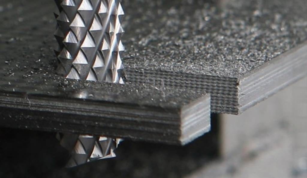

TaeguTec’s diamond-coated tools have been widely adopted in industries requiring precision machining. In aerospace, CFRP components in aircraft wings and structural parts require smooth cutting to avoid fibre delamination. TaeguTec’s nano-crystalline coatings offer excellent edge retention and reduced tool wear. Aerospace customers need consistency. If a tool fails mid-process, it can result in thousands of dollars in costs. Its coatings ensure reliability and consistency, instilling confidence in the process.

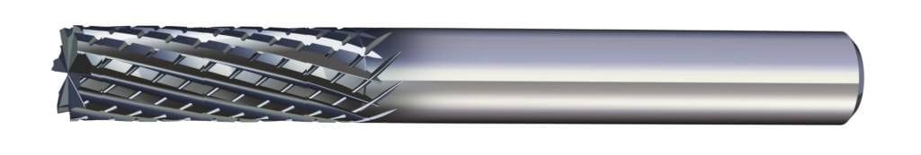

To cater to the diverse demands of the marketplace, TaeguTec’s diamond-coated endmills are available in four different types. The RRFE Series eliminates delamination when machining CFRP while minimising vibration and cutting forces; this is complemented by the RCFE range, a geometry applied to multi-flute routers. With 6 to 12 flutes and a 15° helix angle, the RCFE is part of the DiaMill Series from TaeguTec.
For finishing applications, the RCOM range of diamond-coated end mills, available in diameters ranging from 6 to 12mm, incorporates a left- and right-hand helix, commonly referred to as ‘up-down’ cutters in some sectors. The RCOM eradicates delamination with its unique geometry design. Also from the finish machining stable are the low-helix RDCF-type endmills, which complement the RCOM range and are the first choice solution for addressing concerns related to splintering and delamination on CFRP parts.
TaeguTec has added the new RCDE multi-flute router to the DiaMill range, enhancing capabilities for drilling and slotting. Excellent for rough to semi-finish machining of carbon fibre components, the RCDE presents a geometry that excels at drilling CFRP and shoulder milling operations. All these DiaMill designations have been developed using TaeguTec’s TTD610 advanced nano diamond coating grade, which enhances machining stability and tool life while delivering excellent wear resistance with hardness exceeding Hv 8000. This gives all five end mills the highest possible thermal conductivity, impact resistance, and stability.
